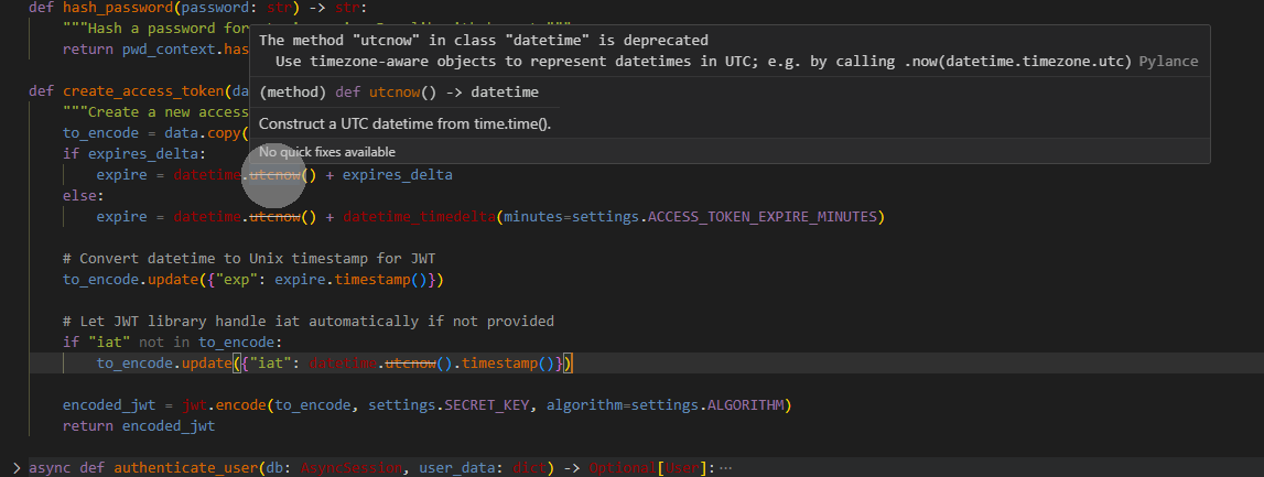

I tried validating access token in https://www.jwt.io/
eyJhbGciOiJIUzI1NiIsInR5cCI6IkpXVCJ9.eyJzdWIiOiIyYThkYzc5M2FlNzQ0YzZiOGI0ZTdiMWJhNGUzZjFmZCIsImV4cCI6MTc1NjEzMDY4MS4zNzM1MSwiaWF0IjoxNzU2MTI5NzgxLjM3MzUxfQ.kNsl-aoOFiWGIFZyn6rxPU4Zmb2xs6xG3gAQEleaY2k
and got “Invalid Signature” error.
I guess it can be because server and my device in different timezones.
Have you made any changes to timezone in recent updates @DJJones ?
I did run into this issue before but it was not from CORS directly.. I had a bad process running in the backrgound and had to reboot the system.
I did clean up some CORS things last week and there is a PR regarding it, I think was last week or the week prior.
Just wanted to valid before I answered, Timezone doesn’t matter. Used UTC
Issue is resolved @davewaring ,@DJJones.
Root cause: The issue was caused by using the deprecated datetime.utcnow() method in the JWT token generation code.
It’s deprecated as of Python 3.12 and the reason for deprecation is that it returns a “naive” datetime object, meaning it does not contain any timezone information. This was causing problems when performing calculations or comparisons with other datetime objects that do have timezone information, or when converting to timestamps.
Recommended replacement: datetime.now(UTC).
I replaced it in create_access_token in backend\app\core\security.py with datetime.now(UTC) and it works now.
Note: There are other methods in the codebase that need to be replaced as well since they also use datetime.utcnow().

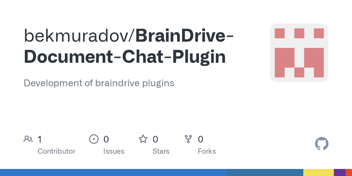

Right now if you wish to see chat with docs in action you would need to download his plugin from the repo ( I do not know the link off hand) and it should do all the work for you. Once we get that tested and mature it a little then we move to the next 2 steps
