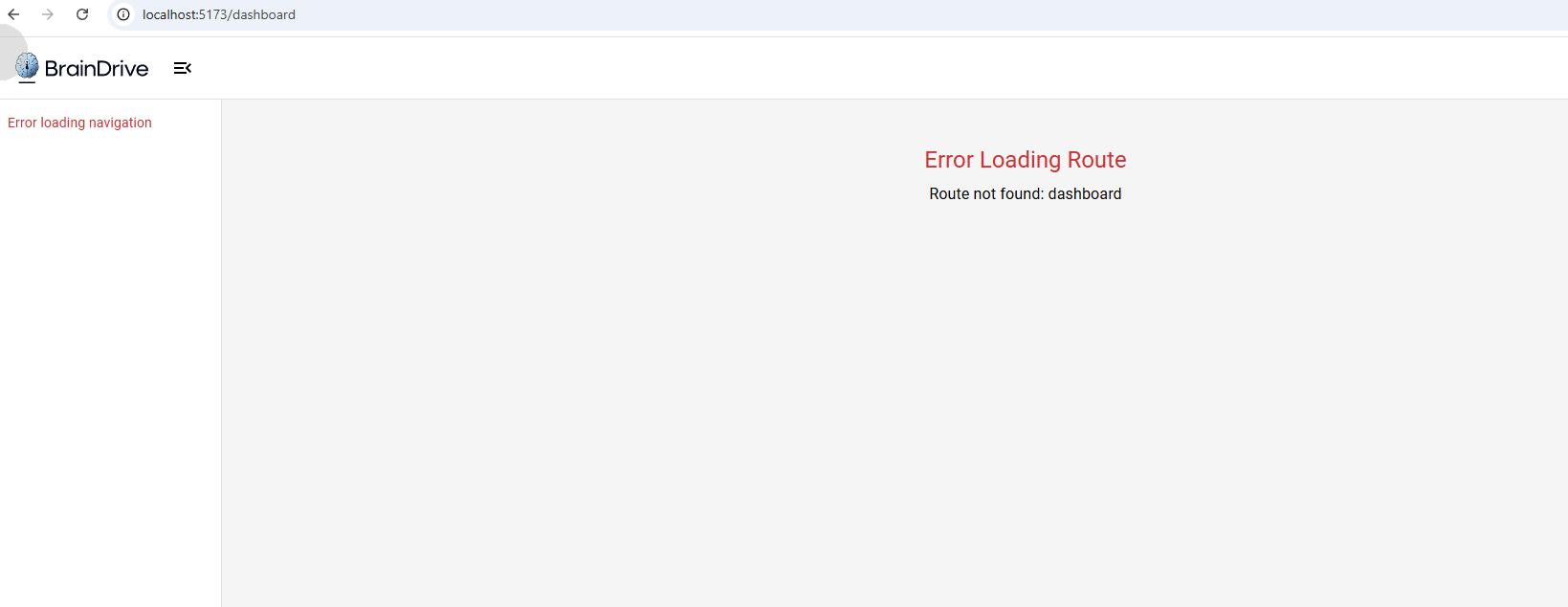

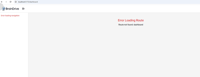

there are some issues with your latest updates on main @DJJones .
It doesn’t Error loading route; Route not found: Dashboard
And about migration script, I found only one new script which was committed on August 14th (it doesn’t seem to be related to plugin service runtime data)

This is a heads up, I have yet to find the pattern, but I have nailed down the error that is triggering.

I was able to get the error in a terminal but not in vscode (yet)
I am making some assumptions the issue exists without the branch because this has never triggered before.  I am also going with it is in the service start up because you didn't experience it before hand.
What I am not experiencing is the loading and sidebar menu issues but the same point that stops for you is the same point above, like I said.. making a few assumptions at this point.  I am going to continue forward on this.

  2. Still seeing dashboard not found error – Even after successful DB migration.
  3. David suspects old user data – Asks Beck to create a new user to test fresh install.

@beck
I thought of a new way to test this and my solution above didn’t solve your issue. If anything it revealed a bit more info but didn’t solve. I need to get this issue to appear in vscode so I can breakpoint it.
thanks for correct import path and wrapper function.
but the functions are being called in backend/main.py (not backend/app/main.py)
I was also confused first, and initially tried adding runtime service auto starter in backend/app/main.py)
Here where start / stop runtime service is actually called:
I am also debugging the “Error loading navigation” issue, and switched back to commit before updating from main (git checkout d1420dd) and the issue is gone. So, confirming that this error happens somewhere after updating from main. Will update this thread once I found the cause.
@beck Yeah, I did something similar as well since the race condition seems to be in registration I did go back to the main to verify it was not there. (I did a billion registrations while I was hardening the CORS so I wanted to make sure this wasn’t present in that PR)
The one thing I have yet to see is your navigation issue. May want to look into the db and sure everything is there that should be since this could simply be an effect from the race condition in the registration that is causing not everything to be handled correctly.
@beck
I am not finished testing yet but did find a solution:
uvicorn main:app --host localhost --port 8005
When removing filewatch it took out the race conditions. This works for me in a terminal for testing and will move into vscode to continue testing. Figured another set of eyes is always good.
In the .env just set reload to false, so far in my limited testing this has worked
# Server Settings
HOST="0.0.0.0"
PORT=8005
RELOAD=false
LOG_LEVEL="info"

I am going to do a new install on bare system see if that exposes anything (This will be from the main repo and not my dev or with the above changes)
Just installed it from the main, no other branches (If I understood what you had said, you experienced the issue here as well)This is the migration section:
✅ Created empty SQLite DB at braindrive.db
Running Alembic migrations to initialize database...
INFO  [alembic.runtime.migration] Context impl SQLiteImpl.
INFO  [alembic.runtime.migration] Will assume non-transactional DDL.
INFO  [alembic.runtime.migration] Running upgrade  -> b059e76c411a, new_baseline_from_existing_db
INFO  [alembic.runtime.migration] Running upgrade b059e76c411a -> f0bc573ed538, standardize_uuid_format
INFO  [alembic.runtime.migration] Running upgrade f0bc573ed538 -> fcba819d216c, standardize_role_uuid_format
INFO  [alembic.runtime.migration] Running upgrade fcba819d216c -> 0a4f64f25f5c, standardize_tag_and_plugin_uuid_format
INFO  [alembic.runtime.migration] Running upgrade 0a4f64f25f5c -> 8f37e0df1aaa, add version field to users
INFO  [alembic.migration] Starting to add version field to users table
INFO  [alembic.migration] Successfully added version field to users table
INFO  [alembic.runtime.migration] Running upgrade 8f37e0df1aaa -> add_plugin_update_fields, Add plugin update tracking fields
INFO  [alembic.runtime.migration] Running upgrade 8f37e0df1aaa, add_plugin_update_fields -> c5130afa654b, Merge conflicting heads
INFO  [alembic.runtime.migration] Running upgrade c5130afa654b -> add_conversation_type_simple, add conversation_type field
INFO  [alembic.runtime.migration] Running upgrade 8f37e0df1aaa -> a1b2c3d4e5f7, add personas table
INFO  [alembic.migration] Starting to create personas table
INFO  [alembic.migration] Successfully created personas table
INFO  [alembic.runtime.migration] Running upgrade add_conversation_type_simple -> add_page_id_to_conversations, add page_id to conversations
INFO  [alembic.runtime.migration] Running upgrade add_conversation_type_simple -> restore_settings_tables, restore settings tables
settings_definitions table already exists, skipping creation
settings_instances table already exists, skipping creation
INFO  [alembic.runtime.migration] Running upgrade restore_settings_tables, add_page_id_to_conversations -> c7eed881f009, merge heads
INFO  [alembic.runtime.migration] Running upgrade c7eed881f009, a1b2c3d4e5f7 -> abb6734b0519, merge personas with existing heads
INFO  [alembic.runtime.migration] Running upgrade abb6734b0519 -> 49d16cc7f8f1, add_persona_id_to_conversations
INFO  [alembic.runtime.migration] Running upgrade 49d16cc7f8f1 -> 7d0185f79500, add_plugin_states_table
INFO  [alembic.runtime.migration] Running upgrade 7d0185f79500 -> cb95bbe8b720, mark_settings_tables_restored
✅ Verified settings_definitions table exists
✅ Verified settings_instances table exists
✅ Settings tables restoration check completed
INFO  [alembic.runtime.migration] Running upgrade cb95bbe8b720 -> 219da9748f46, add_hierarchical_navigation_support
Phase 1: Adding hierarchical columns to navigation_routes...
Phase 1 completed: Hierarchical columns added successfully
Phase 2: Creating parent routes and migrating data...
Warning: Route settings not found for migration
Warning: Route personas not found for migration
Warning: Route plugin-manager not found for migration
Warning: Route plugin-studio not found for migration
Phase 2 completed: Parent routes created and data migrated
Phase 3: Updating display orders...
Migration completed successfully!
