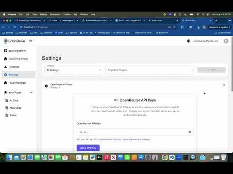

I am sharing a quick update on the OpenRouter API plugin.

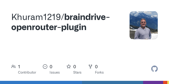

I’ve recorded a short demo video to walk you through the current functionality, and I’m also attaching the plugin repository so you can install and try it out yourself:
Demo Video:
Plugin Repo:
Would love to hear your thoughts and feedback. Your input will be super helpful as we continue improving this.

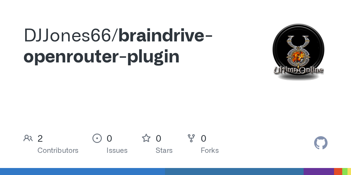

This plugin should be functional now when using with the updated Core from the repo below.
Repo
Thanks Dave. I was able to get the plugin to install by downloading the zip file but the link was not working I think because a release needs to be created.
Also once I have the plugin installed and active where do I go to input the API key? I was looking under LLM servers in the settings but did not see it there.
I guess I didn’t create a release for it, odds are when I was testing to just did all local to prevent someone from grabbing something in development. I created a release for it, you should be able to just install as normal from the link and the panel will be in Settings → LLM Servers.
