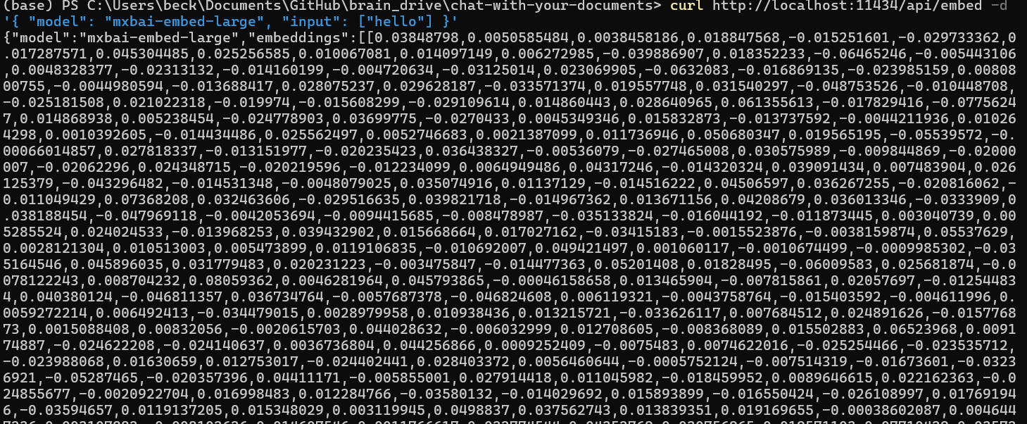

I just tested same chat with docs setup with local mxbai-embed-large ollama model and it works.
Try these commands in your terminal first:
curl http://localhost:11434/api/embed -d '{
  "model": "mxbai-embed-large",
  "input": "Llamas are members of the camelid family"
and
  "input": ["Llamas are members of the camelid family"]
you should see embeddings output in terminal
Thanks Beck will check it out and revert shortly.
Also here is the recording from my call with Beck and Dave today where we discussed all the things we can do to continue building the best local RAG system, including how the community can participate in different strategies for different markets etc.
I think this is a great opportunity for people to jump in and start optimizing the Chat W/ Docs system to work better with specific types of documents and use cases. Most of the stuff out there is one size fits all, and this is not a one size fits all situation.
Hi Beck,
I do see the embeddings output in the terminal. However still getting failure on upload.
