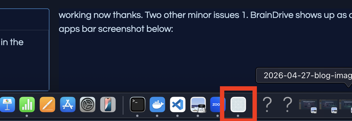

working now thanks. Two other minor issues 1. BrainDrive shows up as a white box when in the active apps bar screenshot below:

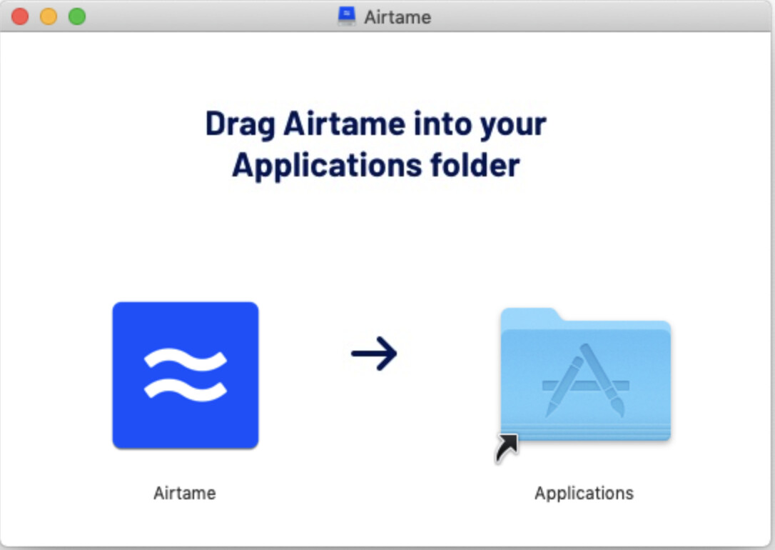

When I click on the installer to open it, it brings up a window that has the app and the applications folder in it. This is close but you have to actually drag the app into the applictions folder if you want it to show there going forward.
The way that I see most apps handle this on Mac looks like this:

We probably want either the light or dark icon for the app Icon.

I noticed the icon as well but at the time I was still making sure the functionality needs getting handled first before heading down that path. Which looks to be the direction we are now heading into.

New version is up, should correct the icon and move to app folder issues
