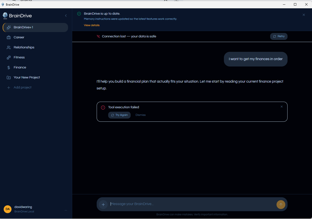

install went smooth with one exception in that it looks like it’s freezing in between where it launches the BrainDrive window and where BrainDrive actually shows up would be nice to have an hour glass there or something and same thing for mac.
The model failed on tool call using the BrainDrive model:
I tested for Ollama and that worked but, I am wondering if this is a tool call issue or what. I will take a look into it.
Next version is uploaded, I am curious if the tests handled this but we will find out soon enough.
yes working now!
