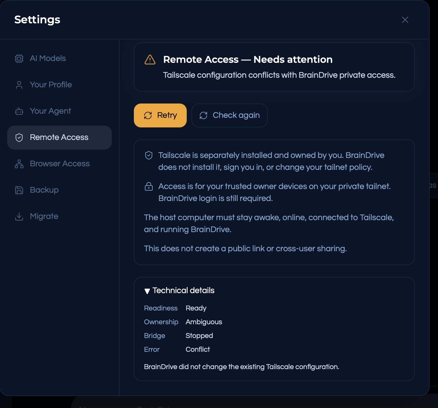

Thanks Dave. I tried out the app but tailscale is not working for me. I think it’s likely because I already have tailscale so was not starting fresh:

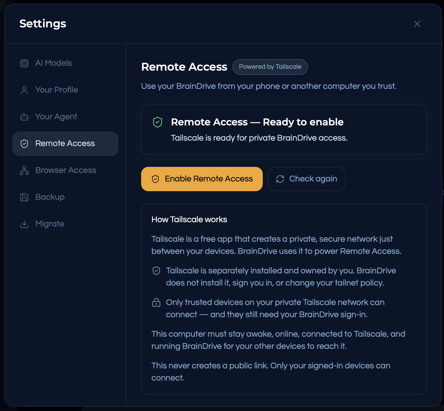

@DJJones ok installed everything fresh and it worked. I made some updates to the UX of the tailscale screen and just submitted a PR with them. Any questions or issues let me know.
Dav e
@DJJones browser access ux changes added to PR 254 as well.
I am going to do research and spec for the issue directed in the PR comments but in my own review I did find this…
Medium risk — destructive recovery guidance. The conflict UI recommends tailscale serve reset in TailscaleAccessSection.tsx (line 371). That command clears the machine’s entire Tailscale Serve configuration—not just BrainDrive’s mapping—so it could disrupt unrelated services. Tailscale documents it as resetting the current Serve configuration. I’d remove the inline command or add a much stronger “this removes every Serve mapping” warning with backup/inspection instructions.
Since this isn’t really a functionality change but more a UI/UX which was the whole point of your PR I am putting this here for us to discuss really quick or if you wish to take a look at how you wish this change to be seen by the user and we go forward.
@DJJones Discussed this on today’s call so just closing the thread for anyone else who is following.

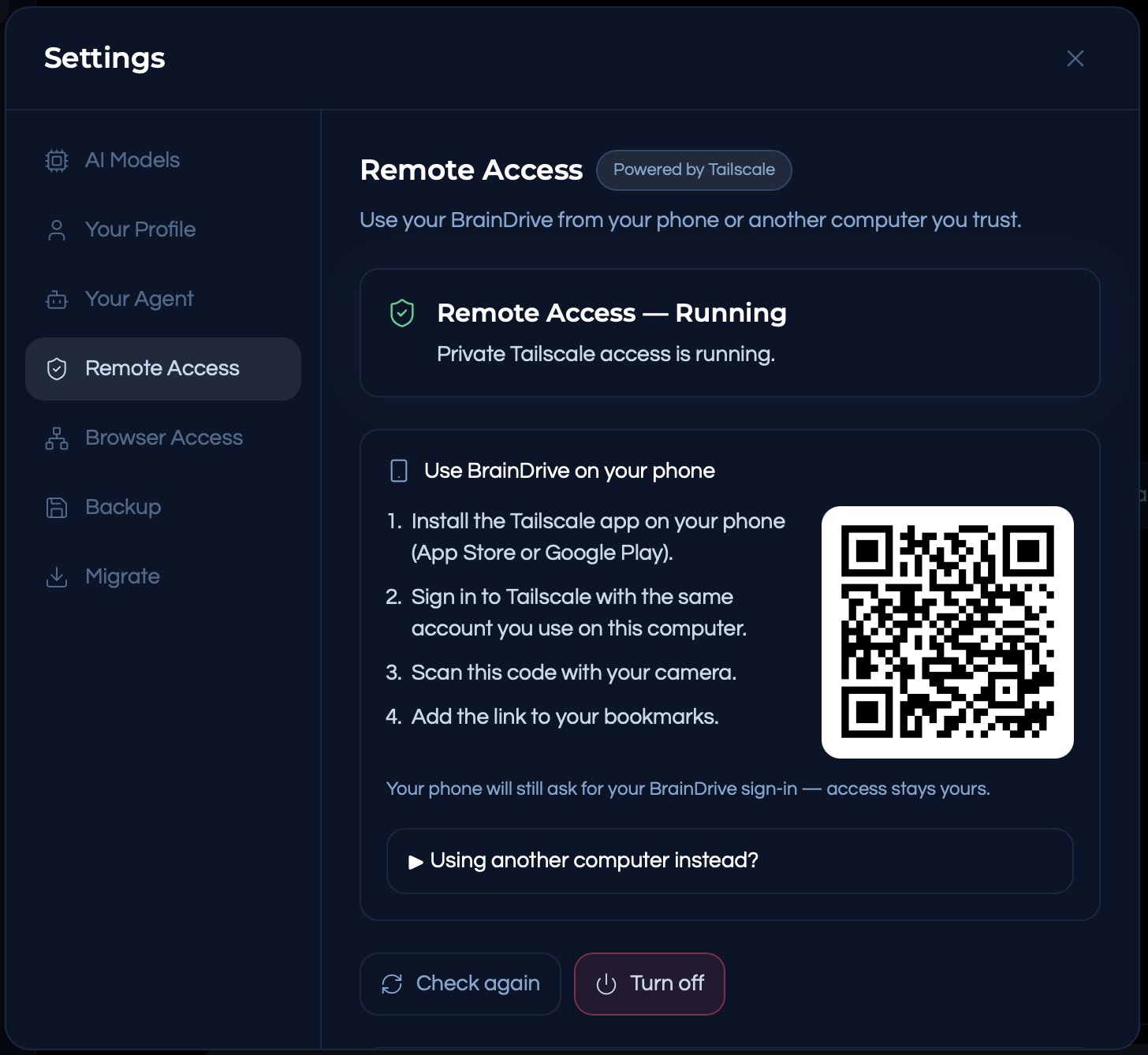

We want to make sure that the “Turn off” button in the remote access settings page just turns off the tailscale connection for BrainDrive and does not remove anything else. It should also be easy to turn back on with the click of a button as well.
Tailscale remote access is now live in BrainDrive!
Step 1: Download Tailscale onto the computer that is running your BrainDrive.
Step 2: Download Tailscale onto your phone or other device where you want to run BrainDrive. Login using the same login that you used on your computer.
Step 3: Scan the QR code or use the link we give you on your BrainDrive remote access screen to launch your BrainDrive on any device with Tailscale!
Remember the computer that is running your BrainDrive needs to be on and connected to the internet for this to work.
If you try it out let us know what you think.

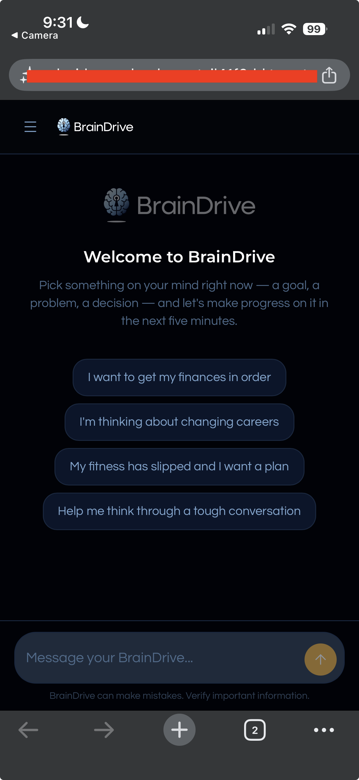

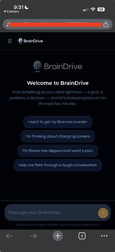

Here’s BrainDrive on my iPhone connected to my laptop via TailScale:
