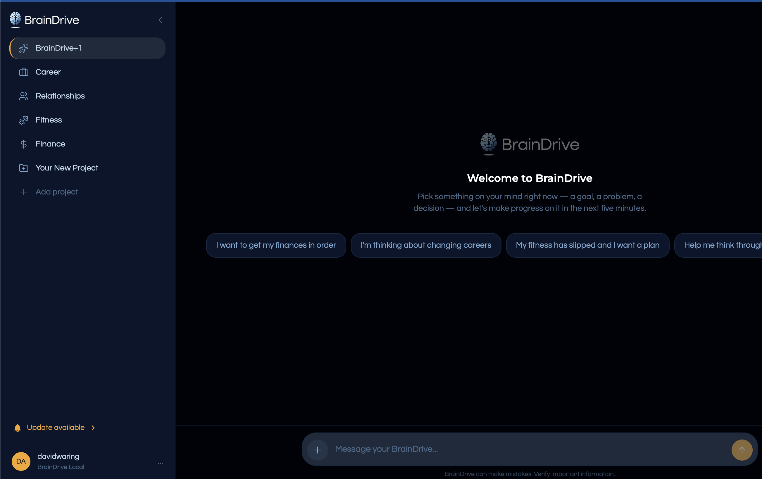

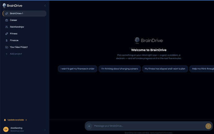

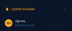

  • Sidebar indicator: amber bell + “Update available” + chevron, lower-left above user name

What’s working: The sidebar indicator lights up correctly on a fresh-owner install (26.4.13 → 26.4.20).

@DJJones it looks like the draft PR with the UX changes I screenshotted earlier in this post did not get submitted. What you have in your branch currently is close enough so I would say just keep going and I can come back around and polish the UX once we get the flow working.
Any questions or issues let me know.

Original UI mockup recovered: Tracked down what Dave W meant about the “UX changes I screenshotted earlier” — the 2026-04-16 sidebar indicator was built as live Chrome DevTools injections against the running app, never written to a file. The final refined script + design-intent notes are now preserved in the Library so it’s not lost for Dave W’s polish pass during testing:
https://github.com/BrainDriveAI/BrainDrive-Library/blob/main/projects/production/braindrive-repo/update-notification-sidebar-mockup.md
Your current implementation (TASK-005, commit da43336) matches the mockup closely — the two visual deltas are (1) lucide-react CircleAlert vs. the custom bell SVG in the mockup, and (2) a thin amber border around the pill that the mockup didn’t have. Both are cosmetic and fine under your “UI changes later during testing” framing.

@davewaring
Is this it?
yes that’s it and i have to keep writing so the forum will let me post thanks
