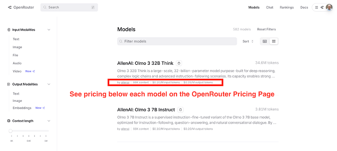

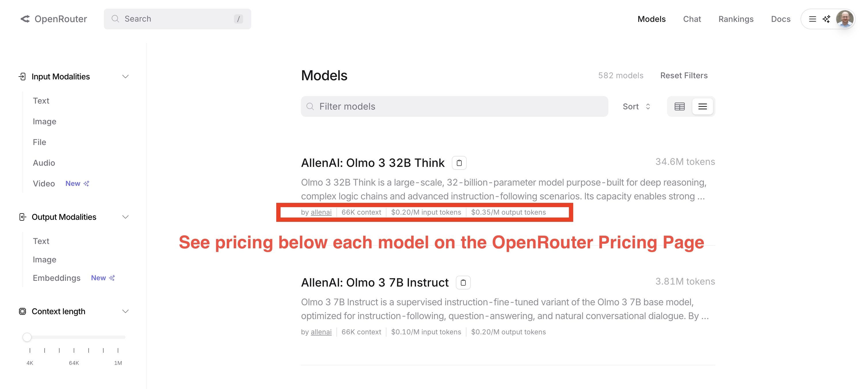

And GPT 5.1 is one of the most expensive models to use. OpenRouter offers dozens of models at lower prices - some are even free.
See all pricing: Check OpenRouter.ai/models to compare prices across hundreds of models. You can filter by price, sort from cheapest to most expensive, and find the best model for your budget.

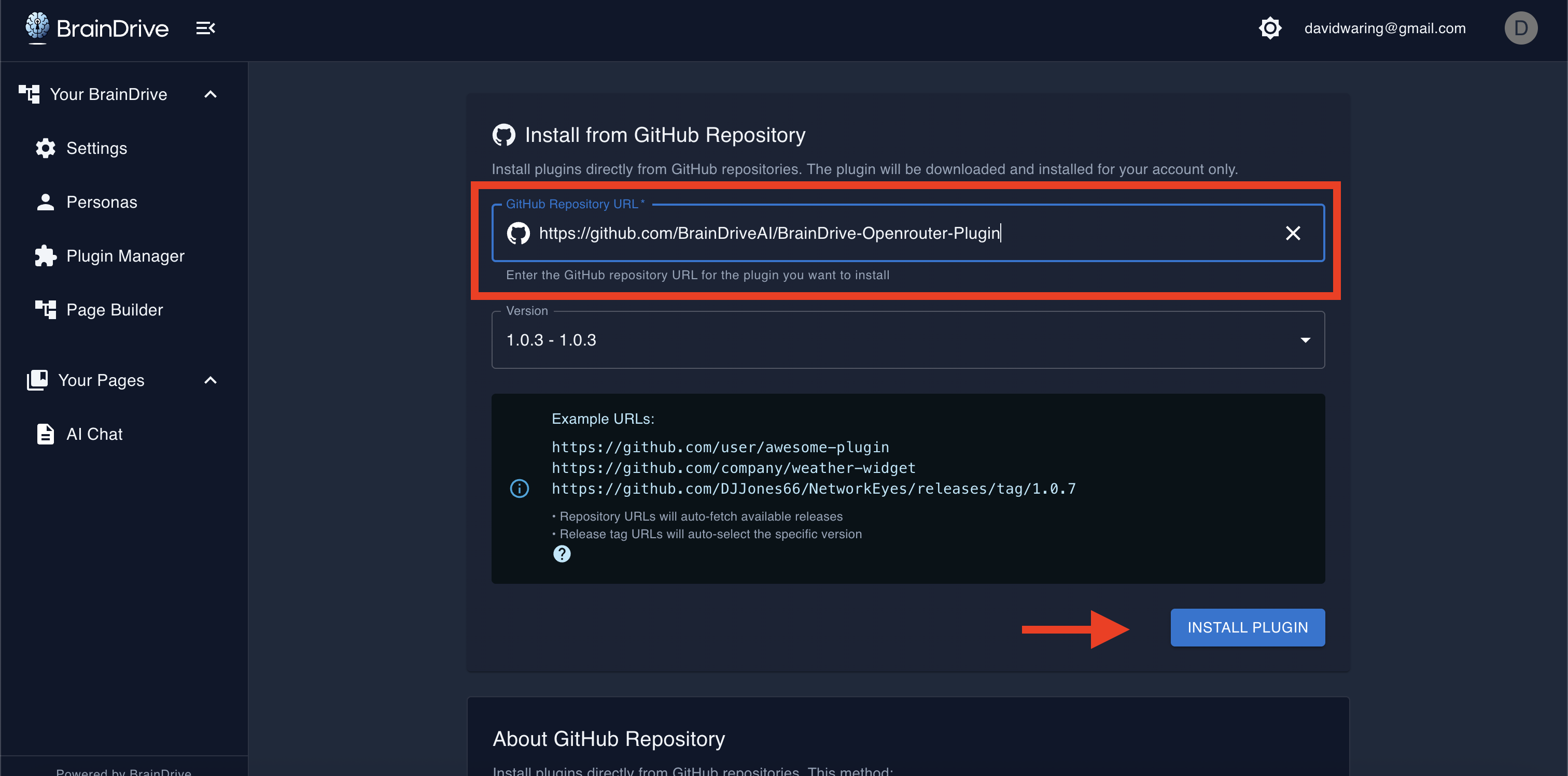

1. Add the OpenRouter Plugin to Your BrainDrive
Your BrainDrive connects to OpenRouter using a plugin.
To add the plugin to your BrainDrive click on “plugins” in the left hand menu.
Then click the 1-click install button in the upper right hand corner.
And paste the OpenRouter Plugin link below in the space provided:

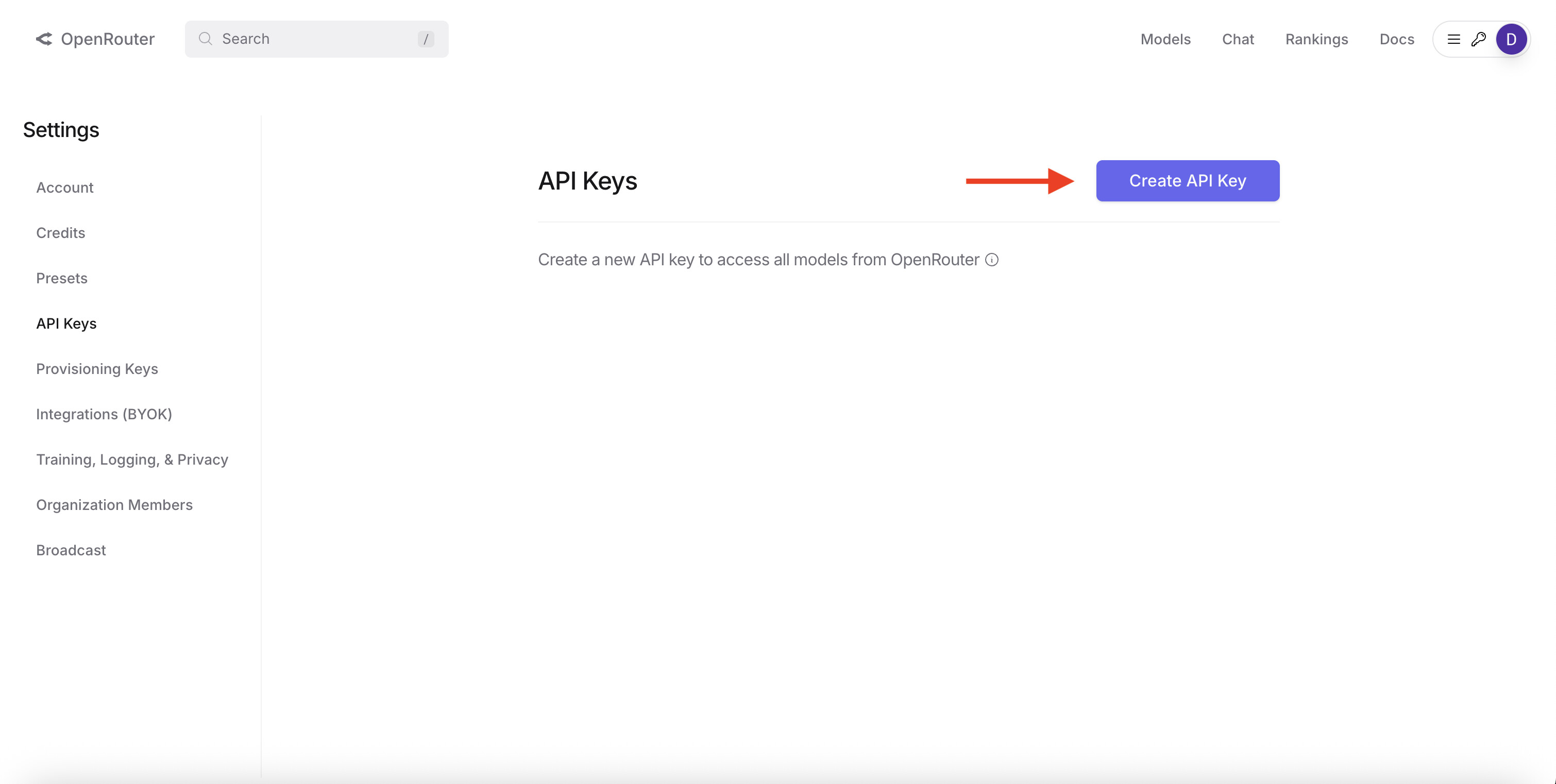

3. Create Your API Key
Copy your API key and put it somewhere safe. It won’t show again, however if you lose it it’s also easy to just deleted it and create another one.

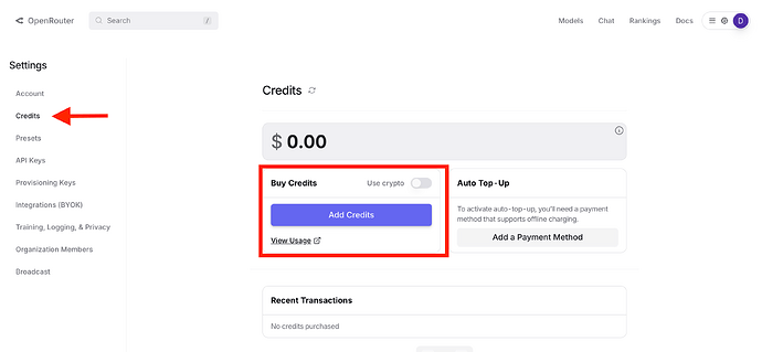

3. Add credits
Add $5-10 to your account to get started. You pay only for what you use.

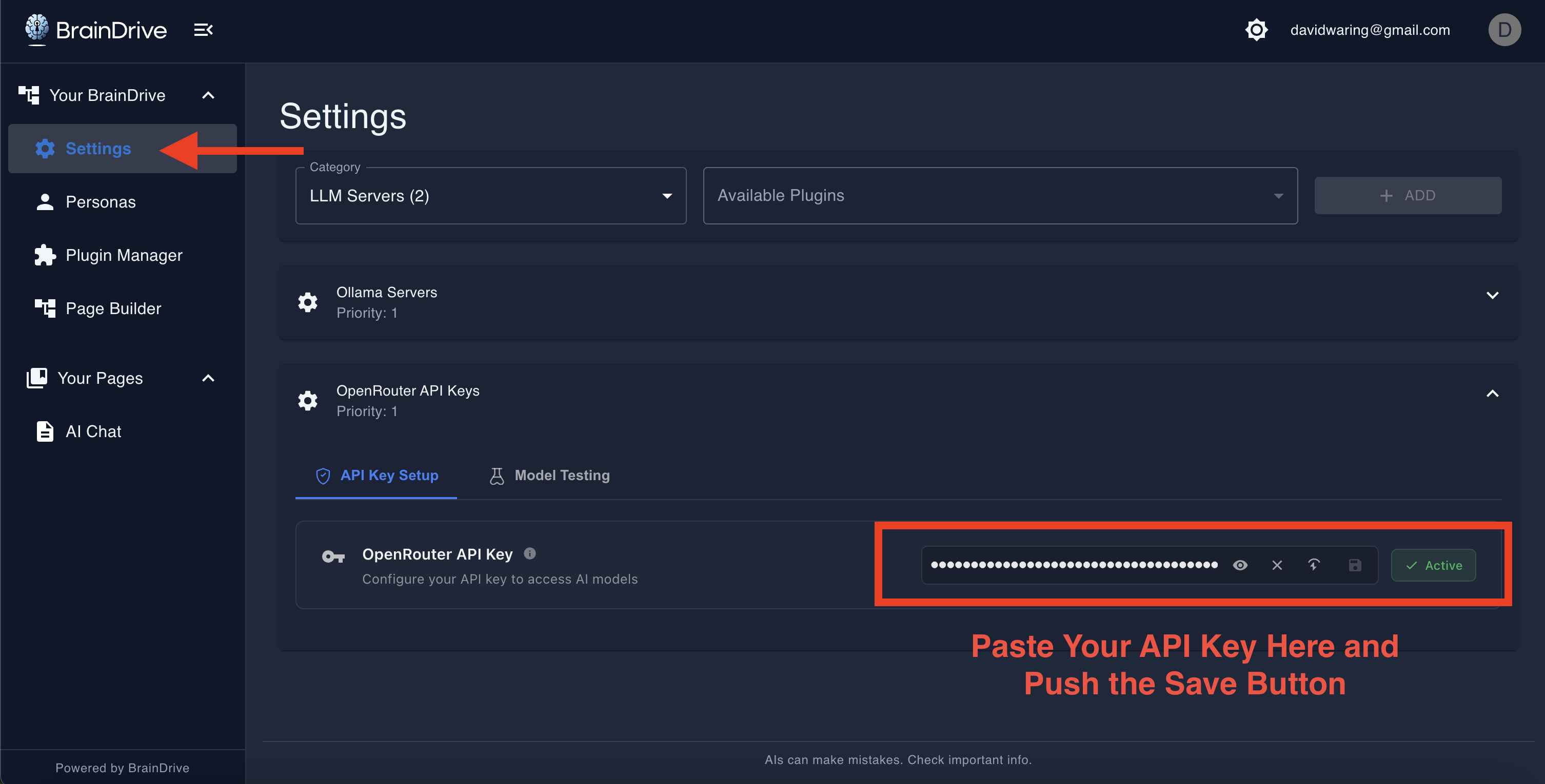

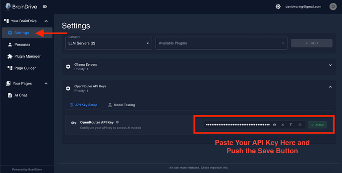

6. Add your API key to BrainDrive
Back in BrainDrive, go to Settings → AI Providers → OpenRouter
Paste your API key and click “Save”

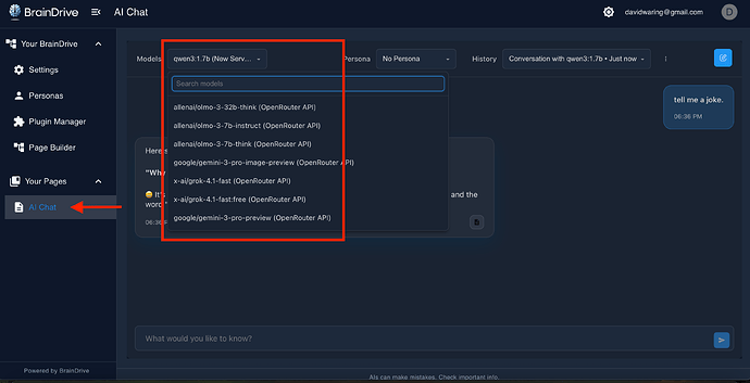

7. Test it

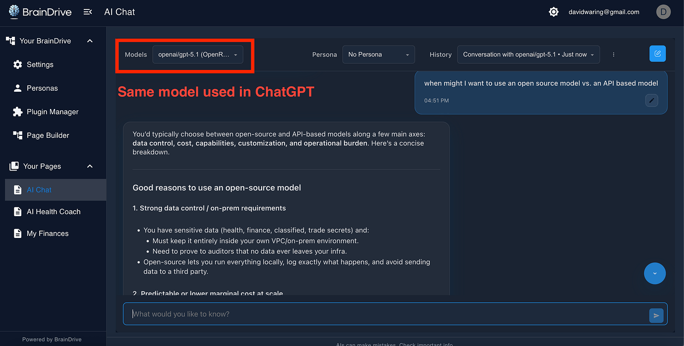

Go to your chat page. The model dropdown now shows dozens of models - GPT-4, Claude Sonnet, Gemini, and more.
Select one and start chatting.
